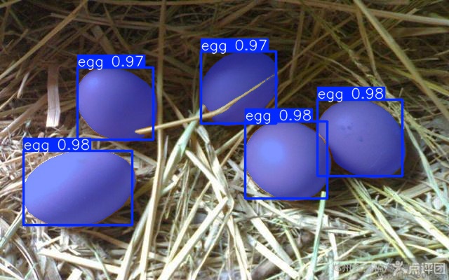

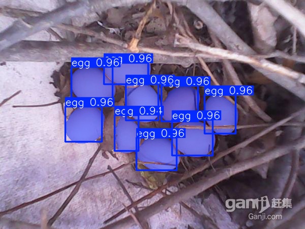

考虑到鸡蛋作为日常的物体,在一些通用的数据集中比较常见。因此可以期望Segment Anything能够对鸡蛋做一个自动的分割。这里尝试一下调用SAM3模型来直接解决这个问题(不需要训练)
from ultralytics.models.sam import SAM3SemanticPredictor
# Initialize predictor with configuration
overrides = dict(
    conf=0.25,
    task="segment",
    mode="predict",
    model="sam3.pt",
    half=True,  # Use FP16 for faster inference
    save=True,
predictor = SAM3SemanticPredictor(overrides=overrides)
# Set image once for multiple queries
predictor.set_image("5xggittuRN1.jpg")
# Query with multiple text prompts
results = predictor(text=["egg"])
egg_num = results[0].boxes.conf.shape[0]
print(f'The number of eggs is {egg_num}')
检测效果见下图
